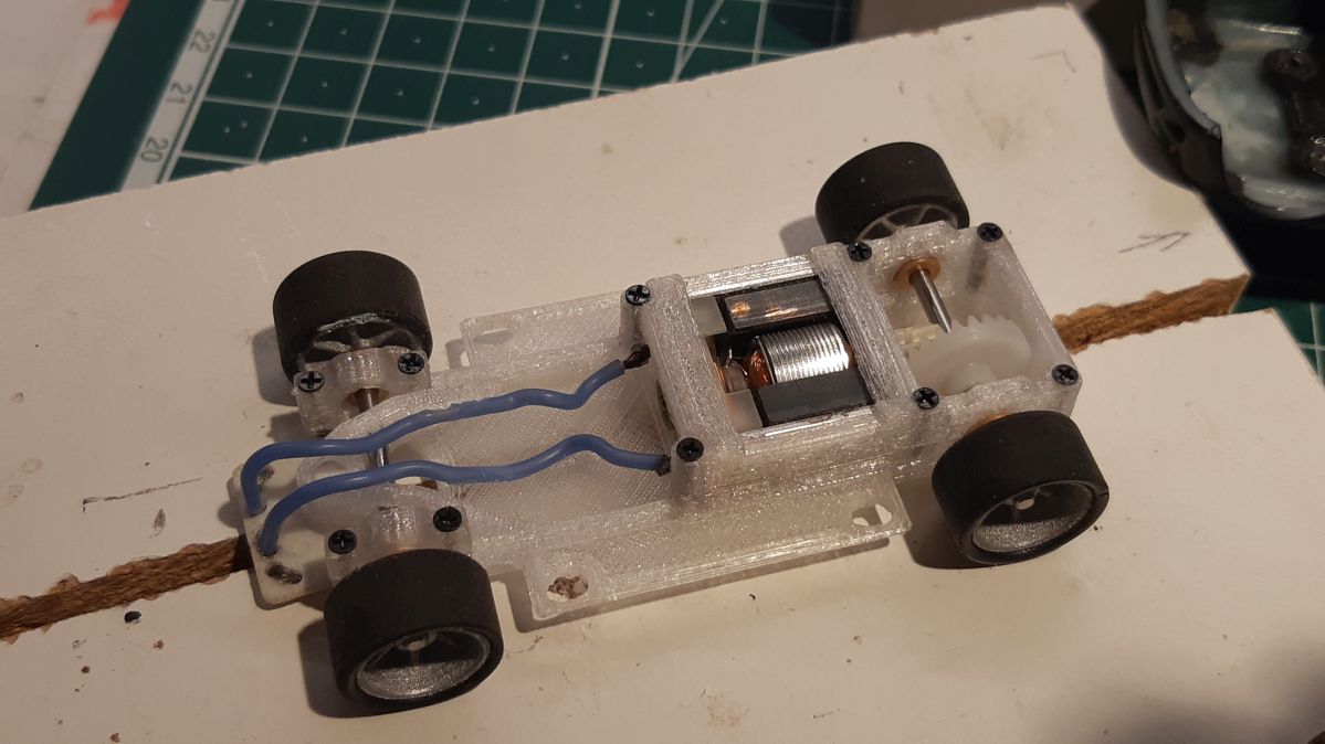

      • side project - water pump pliers with slot for pressing crown gears onto the axles
        the chase cars inspired chassis is running! took some time and some prototypes to get it right!
        and now - the car is too fast! i am not able to see the tilting of the body in the curves!

            evolution on the WackelDackel - pivoting point much lower so the body has more momentum on the springs

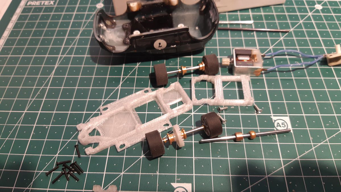

                    some gears for the SideWinder with the small BARC motor - should have more than enough torque for a 1/43 car.
                    with this gearing, the speed should be okay, too.
                    going for 13/20 ...

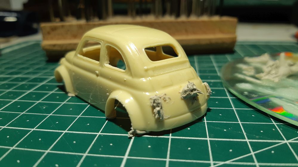

                    some work done on the Fiat.
                    body will need some work in some spots ...

                        • My first build in a long while. This Mercede450 SL I've won in a proxy race long time ago finally starting to take shape. 3D printed the chassis, flag guide and rims. Cast the tire in silicone. Run the chassis without the magnet and to my surprise did pretty well. Hope to finish it soon.
                          • Originally posted by Martin0409 View Post
                            Nice chassis!
                            attention - if i can see that correct, you got a RD-pinion with a Go!crown gear. the RD pinion is a pitch - pinion and the crown is a modul m0,4
                            they will mesh, but i think that the pinion will be the weaker part and gets eaten quite fast.
                            • Thanks for the heads up Peter. I think the goldmine motor pinion will work with the go crown. Or will it not? anyway thanks again.
                              • Martin, i only remember that the goldmine pinion ate away all crowns, but that was due to the power of the G9330 motor.
                                there are Go!pinions as spare parts available in Germany, i do not have any at home, but the shipping costs to Canada became really high. they should fit in an envelope, so maybe those are okay.
