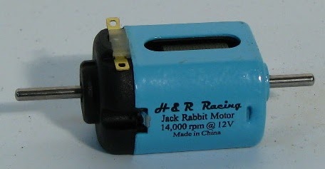

    H&R Racing Jack Rabbit "14k" motor SRP 1090 and 1092 "16k" motors. Pioneer motors; QS Typhoon 21k and QS "18k" in foreground, pro...
