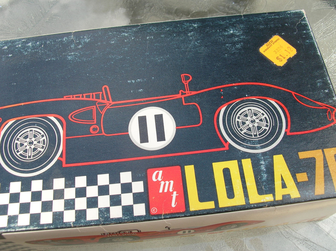

    It seems like I am building a lot of Lola T70 kits at the moment,....this one from AMT. This kit came out in 1965, and despite it being powered by a "chunky" 36D it was one of the better performing/handling kits of the time. largely because of its fairly heavy brass chassis. They made a complete slot car kit, and a static model kit......mine is the Static kit, but I do have an original chassis/motor, and all the other bits.
    This is the original Static kit box......I unfortunately, did not buy it for $1.12. ............the kit came with the slot car body mounts, slot car interior, and all the other bits to make this into a slot version.
