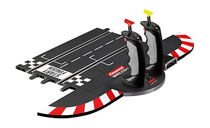

                      Haha, drag it around in a trailer. Got a kick out of that modification. That looks like an expensive way to go by purchasing the Carerra analog / digital track piece and set up box @ $250.00. Possibly I could find a used one somewhere.
                        Isn't this all I really need? Just replace my digital section with this? However I'm not sure if my digital power transformer will plug into this?
                        Carrera 10115 2.4 GHz Wireless Set for Analog (Evolution) 132
                          You CAN just put that in, INSTEAD of the control unit [but never have an analog power track and a CU hooked up at the same time] You WILL need an analog power supply as your digital plug will not plug into the analog base. But there are a couple of caveats..
                          1. If you have jumper wires, they must be run SEPARATELY from Lane 1 to lane 1 and L2 to L2 to run analog [and + rail to +rail and vice versa].
                          For instance, your digital track is essentially 1 lane ELECTRONICALLY. If the track is DIGITAL ONLY you could run one 15' jumper wire on lane 1 and just run a short jumper across from L1 to L2 on the section of track that the 15' jumper is ran to [ eliminating the need for another separate 15' jumper for L2].
                          2. I'm not sure if this has been disproved or not, but when I built my track years ago, I and most guys were filing the ends of the rails just a little on the Lane Changers where the lanes meet in the middle, between the 2 LC track sections to prevent a short from L1 to L2 when running analog.
                          Anyone that knows for sure that this does not need to be done, PLEASE feel free to state that here.
                          3. I don't have a curved LC, but have heard that they are wired differently than straight LC's [maybe a jumper between lanes?] and have to be modified somehow? Not sure on that one.
                          I swap between CU and analog control tracks on my layout and have had no issues.
                          One unintended benefit if you get the 10115 set that you pictured is that those controllers will also work with the CU for digital racing.
