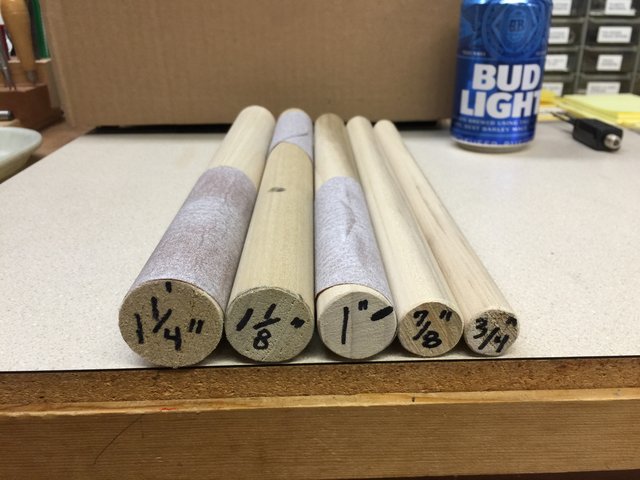

    So I just wanted to share how I sand out my wheel wells on my cars no matter the scale...1/43, 1/32 or 1/24-25! It's pretty easy to do with the few pictures I'm posting!
    First I bought these different size wooden dowels(as marked on the ends) at Home Depot or Lowe's...can't remember??? Then I got the sticky sanding pads from work but I'm pretty sure you can buy them at any of your big store hardware places. Wrap the sand paper around each size dowel and make sure it is stuck tight!! Then pick the size you want for the size car application that you want and the diameter of wheel well you want...measure the outside diameter of your mounted tire and then go from there on picking the diameter of dowel you want to use...remember sanding paper adds a little to diameter!

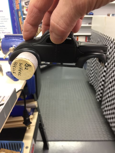

    And I found this works perfect with plastic or resin cars...make sure to have a vacuum and mask handy...then set your car wheel well over top off the dowel and start running it back and forth till you get your desired shape and depth you want!! Try to keep even pressure as you go back and forth but the nice thing is is that you can put pressure on either side to even them up if it starts getting out of whack on one side or the other!!
    Hope this helps someone out cause I used to have a heck of a time with wheel wells till I came up with this and you can shape them however you want after you have you desired shape!!

    Excellent idea! Put it in a drill to make the process quicker.
      Great minds think alike a Broman except I use sockets rapped with sandpaper to get the various diameters

        Was wondering, which diameter rod do you prefer for 1/32 scale?

          I believe that was the 1" dowel...always depends on the OD of the mounted tire and the "look" you are looking for

          I work mostly in 1/24, but I just take the wheel/tire I am actually going to use on the car and wrap it in a course sandpaper, and then finish later with a finer grit.
          If it is a crazy Modified with really hogged out wheel wells, I will drum/Dremel first to get it in the ball park.
