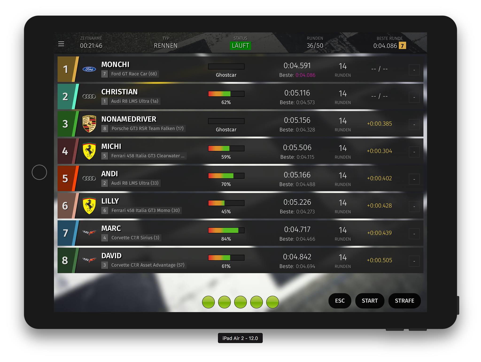

    This is a thread for FAQ's and general discussion of Marc Bonsel's excellent SmartRace Timing and Scoring App for Apple & Android smart devices that uses the AppConnect Bluetooth device to connect with Carrera D132/D124. The App is available through the Apple Store for iOS and Google Play for Android.
    Link to SmartRace website
    SmartRace is an app for timing and lap counting for Carrera Digital and analog slot racing, available for iOS, macOS and Android.
