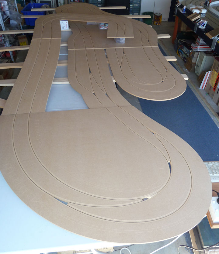

              This is a 4 module portable track, in his "Fiorano" design

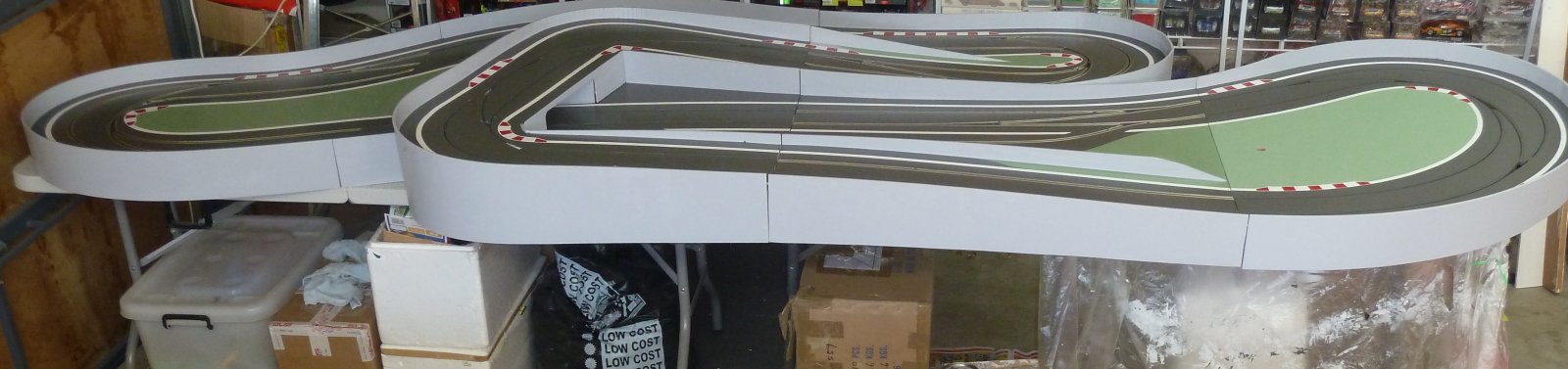

              And painted, electronics installed
              Assembled. I built this with oxigen in mind. But after I broke myself, a friend in club acquired it, completed the
              wiring and cannibalised his Carrera digital system into it.
              The running length is about 12 metres, suitable for about 6 drivers.
              With this, or any other routed system, you will get best result if you get custom aluminium flippers CNC cut,
              which follow the flow of the curves.
