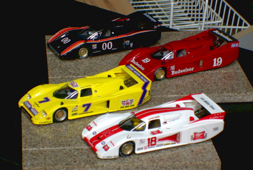

    I have had a painted body of the gorgeous Fly Lola for quite a while and I finally got around to it. Its the yellow one. I used printed circuit board material for a plate chassis, with brass soldered to it, suspending the front axle well above the plate. The drive unit is an old Fly pod drive, motor and drive axle as one.

            Okay, finally got on this. The shot I did before was for a diagram I want to put together to try to be able to print a chassis plan using these elements, just rearranging the parts to fit whatever I'm trying to do. So, it would be useless to post. I took another picture, and here it is. I try to make a chassis as simple as possible. The only other thing I would do to make this version better is to cut kerfs on either side of the motor/axle carriage for flex. I've done that with this PCB material in 1/24th, and it worked great. I'd have to thin the material to compensate for the lightweight 1/32nd. The places where you see double layers is to "sink" the screw heads to allow for the lowest practical chassis height.
