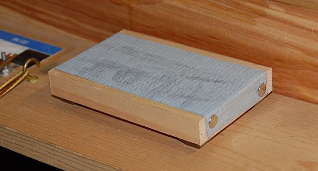

      I see that you have switched to silicone tires, when those get coated with dust they lose most of their grip. You will need to clean the tires from time to time, the quick way to do that is to roll them on sticky tape. I tack some tape to a piece of wood like so:
      It is best to wipe the track down with a microfiber cloth before you run your cars. Running the cars and cleaning the tires will eventually get up the last traces of dust where the tires roll and little cleaning will be needed after that.
