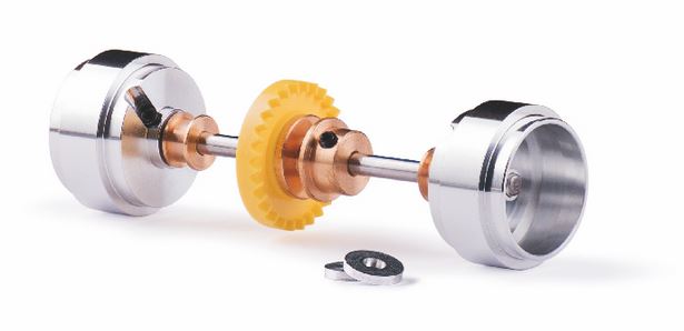

        Measure the O.D. of the wheels with tyres fitted.
        Then simply choose one of the Slot.it inline replacement kits,
        KK01 has the smaller 15.8mm diameter hubs, and is the likely fit if you want an outside
        diameter up to say 20mm

        or KK07 which has thew larger 17.3mm wheels if you want a large OD up to 21.5mm
        Mate those with any Slot.it or NSR tyre for the rim diameter -to suit your track surface
        Slot.it make an OZ wheel type insert for the smaller hub, which is quite similar if you want accuracy
        They are for their DTM Alfas, but look about right.
          OD = 19.5, ID=17.0, OW=10.5

            Hi Frank
            As I mentioned in my private message yesterday your best bet is to pop one of these axle kits in from SCX. Less than $10.00 shipped. This kit even has the upgrade bronze bushings
            https://www.ebay.com/itm/SCX-SCALEXT...-/292536714355
            The wheels are a very common size - 15 x 8 and all manufactures have tires that will fit these wheels. I had these same cars for the kids many years ago and this is exactly what I did to them so so they could use off the rack tires. I went even further and purchased kits for the front end and just used the wheels and tires from those kits. My local hobby store was blowing these axle kits out for about $4.00 a piece at the time.
