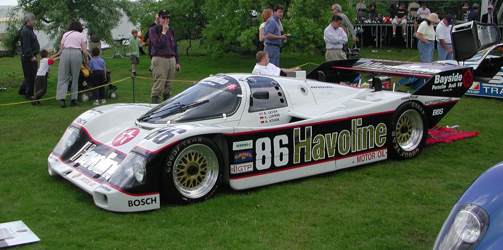

            I agree Rich, that would be an awesome livery! And so would this one!!

              Looks good! That car is a 956.
                Unfortunately, slot.it doesn't make that version of the rear motor cover (aka bonnet). It really doesn't make the correct one for the all black Havoline car. But I do like the white and black paint scheme.
